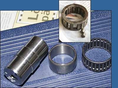

This connection rod pin is clearly worn and needs to be replaced:
Above: The small picture shows the original roller bearing (with cast aluminium body) which were not very reliable on the long run. These are no-longer availlable, which requires that different type of bearing is used:
Main picture, from left, is the new connection rod pin (the center has bigger diameter to accommodate the new bearing). At center is the new bearings inner race and on the right the new needle-type roller bearing. This bearing has bigger diameter on the outside than the old one, so the connection rod big end needs some grinding.
