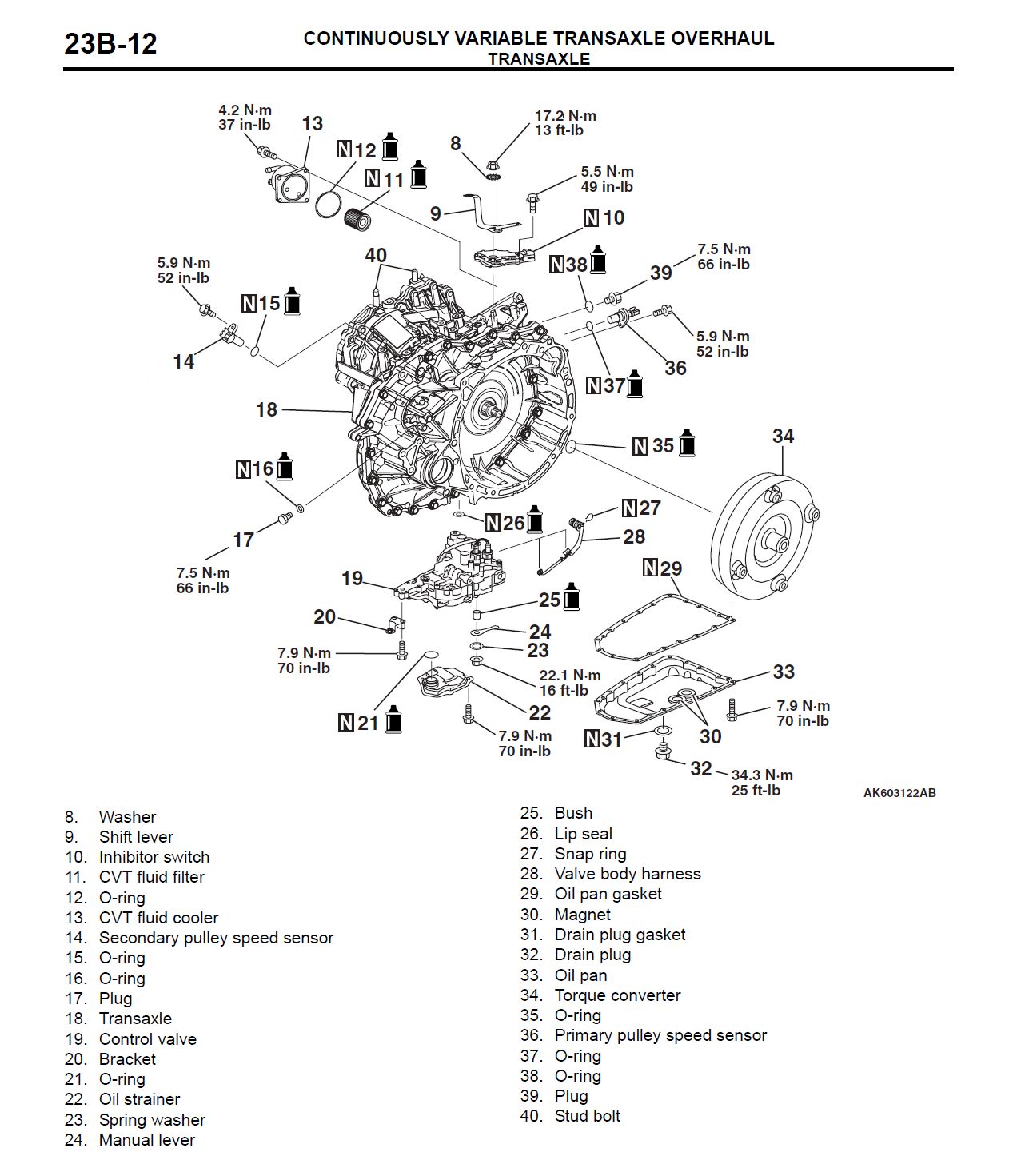

Yes the CVT does have a Filter .... Its inside the Transmission Warmer/Cooler
the little strainer trick!
يوجد لفتيس الانسر cvt
فلتر زيت فتيس وهو داخل
مبرد زيت الفتيس !!
فلو لم نستطيع تغييره
بجديد
فعلى الاقل علينا بغسله وتنظيفه بالبنزين
قبل وضع الزيت الجديد داخل الفتيس
الاوتوماتيك cvt !!!!!!!
I figured better safe than sorry
I think I read somewhere that the cvt fluid actually has additional friction particles (for lack of a better term) to allow the belt to grip the pulley more tightly.
Car manufacturers don't just design the transmission, they design the oil too.

ENEOS CVT Fluid
ENEOS CVT Fluid
The color of most ATF products are red. CVT Fluid comes in red, green, and blue. The color difference is due to color dye added during blending. It does not reflect actual product content.
Due to the specific fluid functions each of the transmissions require, in case of an accidental mix-match of fluid in the transmission, there is a high risk of mechanical damage that could occur. Worst case scenario, the transmission will fail due to inproper friction modifiers the transmission parts are exposed to. If you do accidentally filled your transmission with the incorrect fluid, you should change it out immediately.
CVT Fluid Change interval 30.000 miles or 24 months !!
which one comes first !
